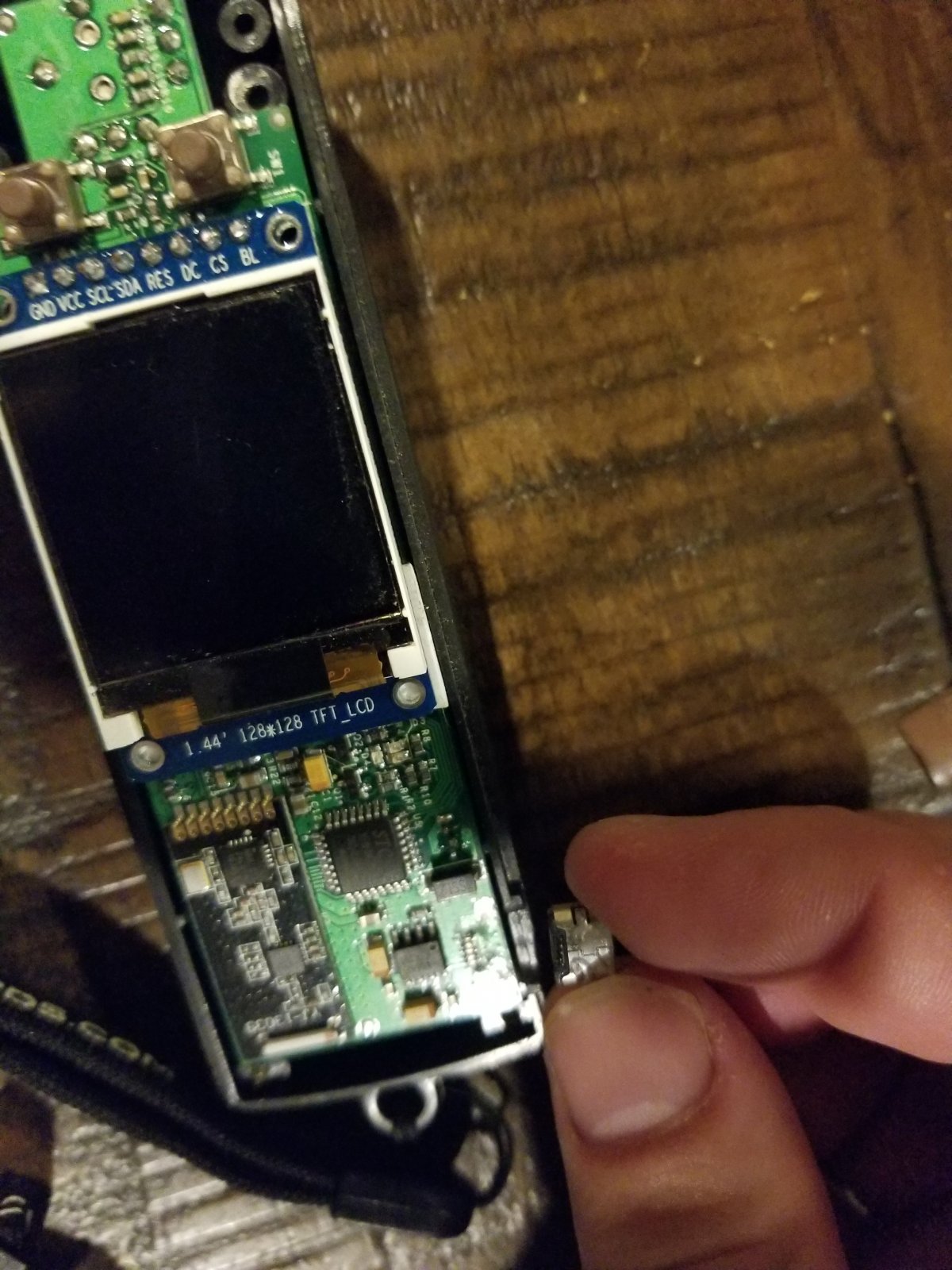

  15. destructo8
    destructo8 Member
    I have 2 remotes because the original was giving me some issues. Decided to send back my old remote for the new upgrade with safe mode. A couple days after I got it back, I attempted to charge it for a second time since sending it out. This time it wouldn't charge. Decided to open it up and the charging port? thingy fell right out. So basically, the remote works fine (as it did before I sent it back) but can't charge it. If I hold the charging port to the remote in the right direction, in the right way, with all the stars aligned it will charge but I can't keep it in place. Any way to fix this?
