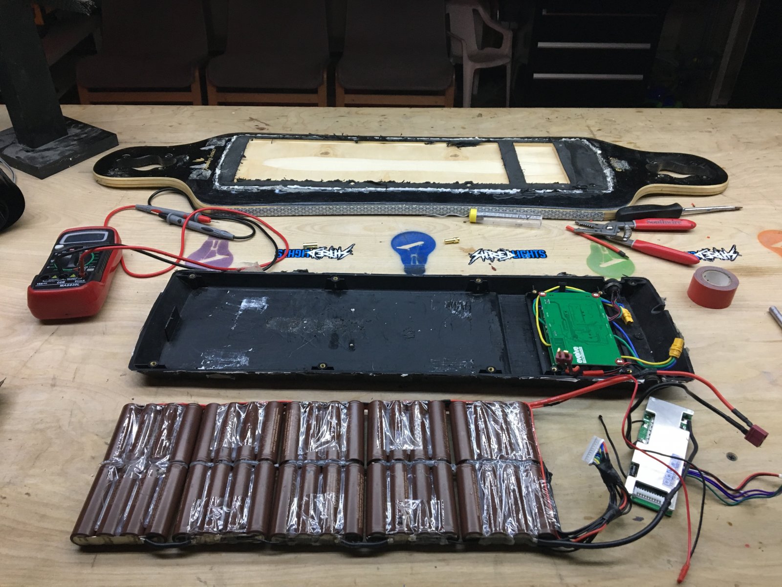

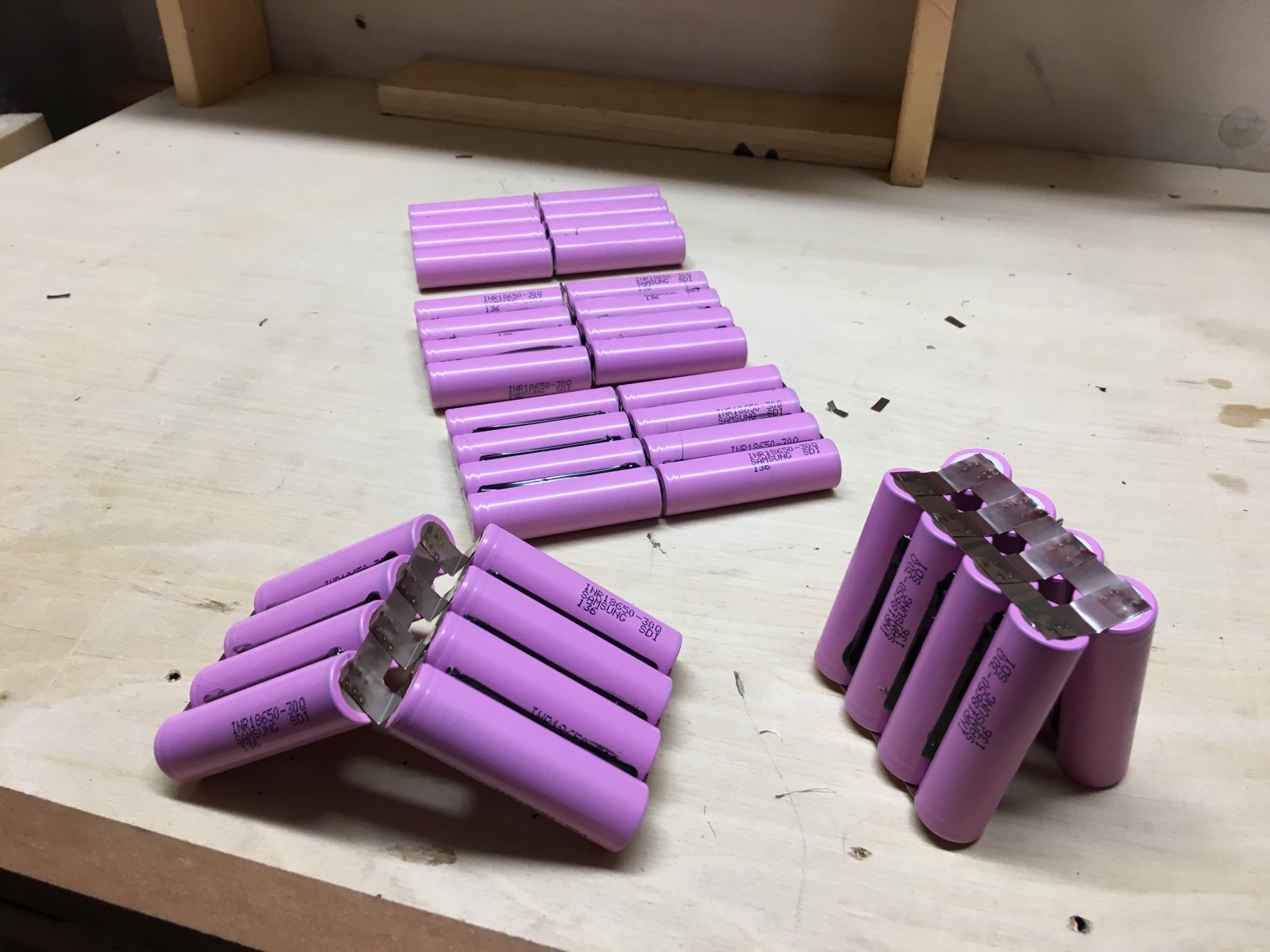

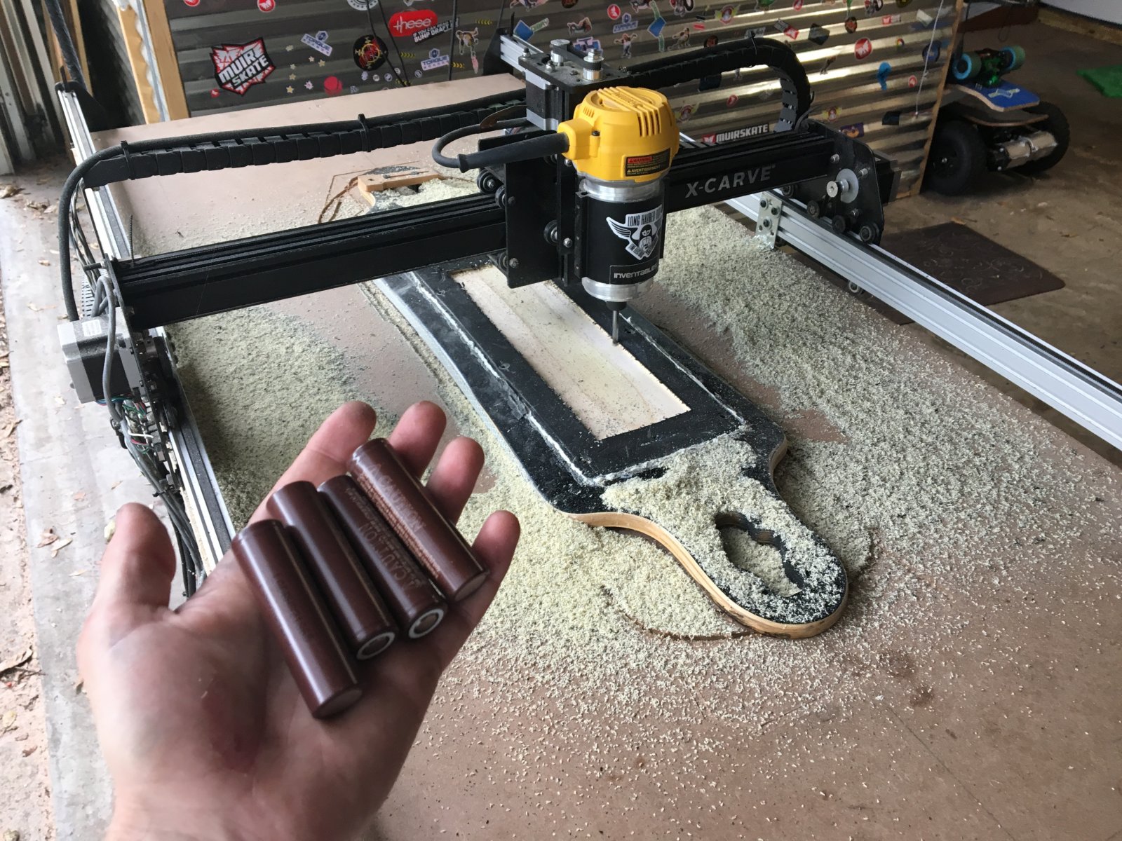

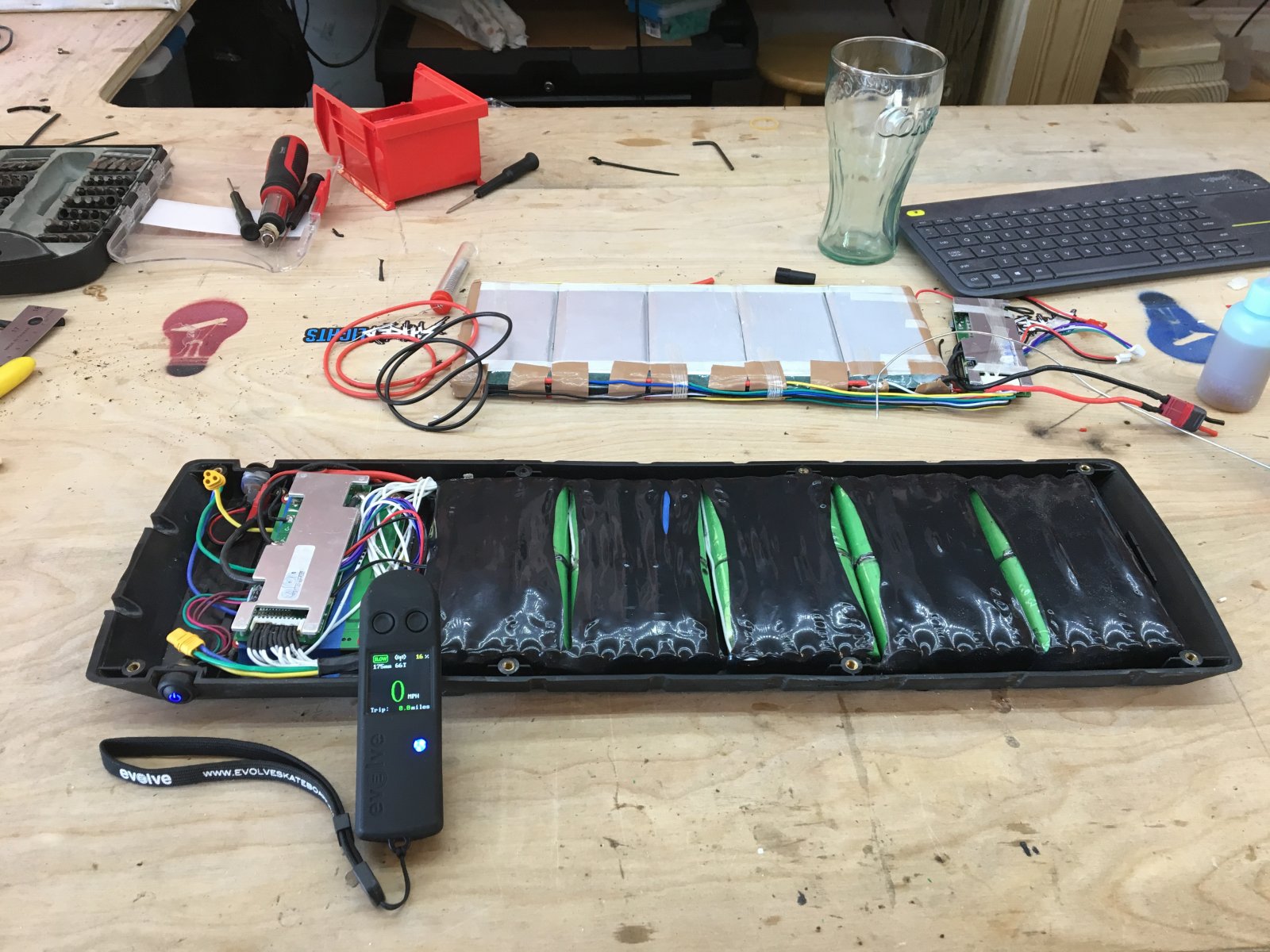

  13. longhairedboy
    longhairedboy Member

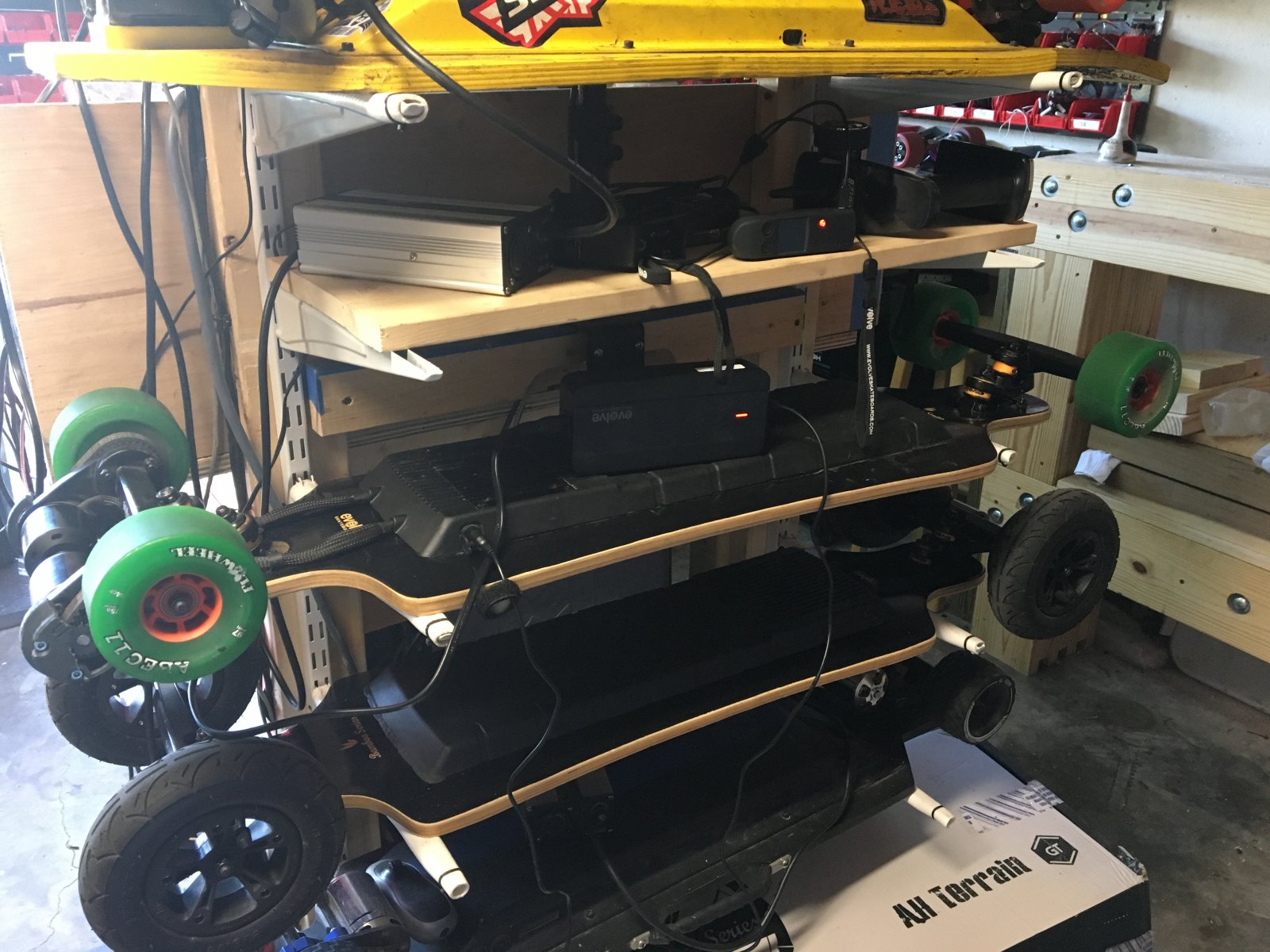

    I just dropped these HG2s in one last night.
    That pack wasn't shrink wrapped yet when i took the pic, but when i shrink them they look like this:
    The pack is super flexible. They basically roll up in a curl if you want them to. That's because i tack them into 2S4P groups like this:
    Then connect them with high strand count silicone wire, essentially the same wire they use in mains in these boards. Except they use 14awg mains in thiers. Makes you wonder what kind of current they were expecting. I use 10awg leads off the pack in my boards and split into two sets of 12awg after the eswitch to feed the motor controllers.
    I've done a few now.
    And yeah, whatever cells you want. Buy them and send them to me and i'll put them in. I've gone Sammy 25Rs and 30Qs, LG HG2s, and Sony VCT5s so far. The Sammys are still the best bang for the buck in my opinion.

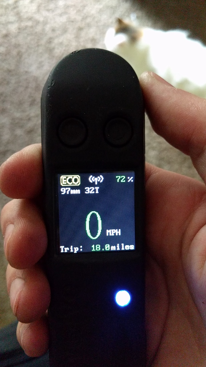

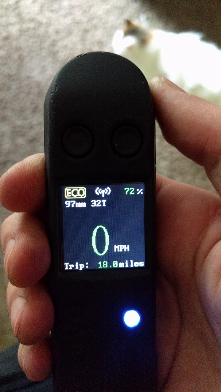

    I'm BLOWN AWAY by the performance so far. Yesterday I rode for about 13 miles with quite a few hills and the lowest my battery reached was about 30%. When I got home it was reading 58%. (97mm). Unfortunately my motor clicking turned into a grinding noise so I'm waiting to hear back from evolve before I do any serious range tests with both sets of wheels. All in all I'm extremely satisfied though.
  19. OP
    Jer
    Jer Member
    I had to stop because my feet were numb, but wow I'm impressed. Keep in mind it was a mix of up and down hill, and I'm only 135 lbs.
    • Like Like x 3
