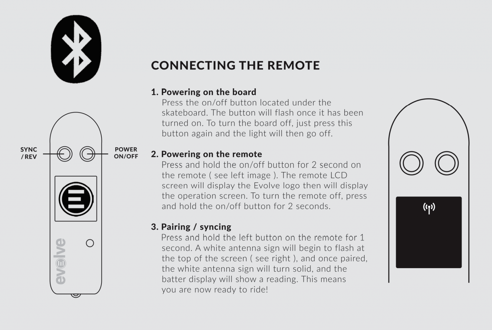

    By the way, I don't see anything in the manual that states to NOT mess with the trigger or roll the board while pairing. Did I miss something? Here's the screenshot of how to do the pairing:

    Strange. I know if you push trigger when pairing with the board the board can move forward on its own. It then seems to set neutral as the point is was pushed when you pair. So neutral becomes like you have pulled the trigger. Back on the horse :thumbsup::beers:

    You won't see anything more in the manual, the stock one provided was very poor, full of mistakes and pictures of actual gen 2 boards not the GT, the new one is one I actually did because I thought users could do with better info. I really think that they should do constant updates through the company and let people know about these things, or else how is one to know the best way to pair or what to do if they have issues!, you don't want a new user to pair the wrong way and end up in your situation, to make a post only takes a few minutes if that, perhaps they should employ a social media person who can keep up with good feedback.
