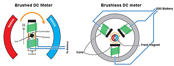

    Here's a thread that discusses more in detail about the motor temps, funkyj did some good debugging trying to identify why this was happening:
    Motor temps - right vs left
    Funky's conclusion is that if the motor is running in the opposite direction or pole that the reverse happens, the other side heats up. So I cough this up to very cheap / low cost motors honestly. As I mentioned we found them at retail cost for $40 a pop.
