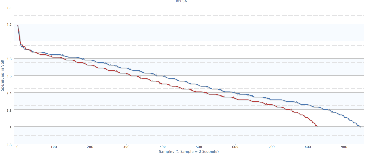

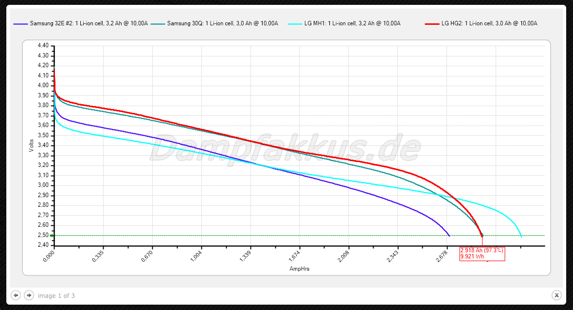

    I think you can´t get more power with stronger motors, the strength will be less. The max current to the motors is limited to 30A per Motor. So you have to use more efficient motors to get more out of it or a power board redesign. But I don´t see any reason why you would need stronger motors. I´m 225 lbs and the torque is more than enough.
    But for the batteries LG HG2 (brown) are perfect. Samsung 30Q´s (pink ones) are good as well(maybe the same) but I don´t know if they fit as 5p10s but since they are a bit cheaper it´s worth a try.

  5. Spartan117
    Spartan117 Member
    The problem is that the requirement for the motor to run at top speed (rpm) you need more than 30A. The whole motor is less efficient. So you will lose top speed and toque if you keep the original power board.
    So... yes it has more rpm´s per volt, but the current is limited by the power board, so it doesn´t work :(

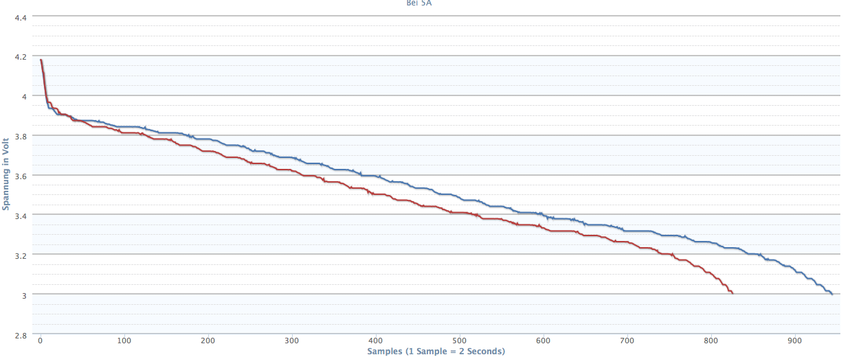

  7. Spartan117
    Spartan117 Member
    Here is a direct comparison between 25R an HG2 at 5Amps. As you can see the voltage level under load is a bit better on the HG2. I cant say anything about quality in terms of cycles yet, as my battery pack has only a few rides on it :)
    At least I know it´s way better than the VTC6. I´ve seen a test comparison where the LG HG2 had more max capacity than the VTC6 after only 25 cycles
