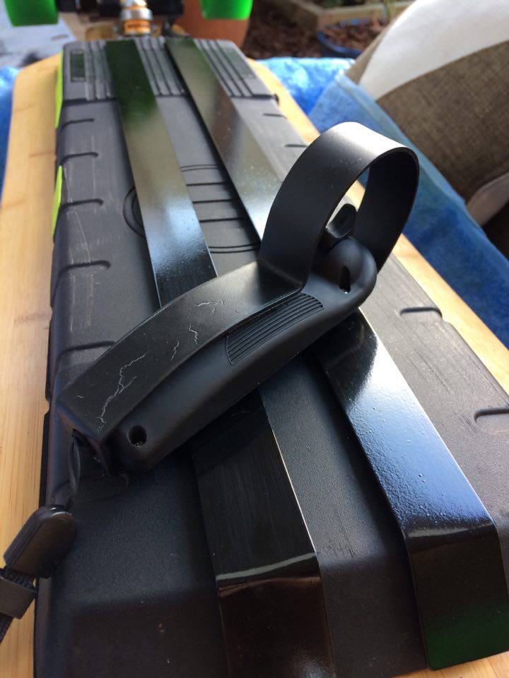

  6. H Guys, thought I'd post this. Is inspired by Nickelberry's 3d printed guard + battery wear plates.. I got a few local quotes for the 3D printed guard, thought It'd be easier making my own out of aluminium. (apologies if there's a forum topic already for this)
    • Like Like x 6
  7. (Turns out the 20mm x 1.5mm thick aluminium strips + velcro) at the local hardware means you can make your own remote guard, battery plates & engine bumpers :)
    Board in excess of $1,500.... $4 strip of aluminium ... (thanks evolve)

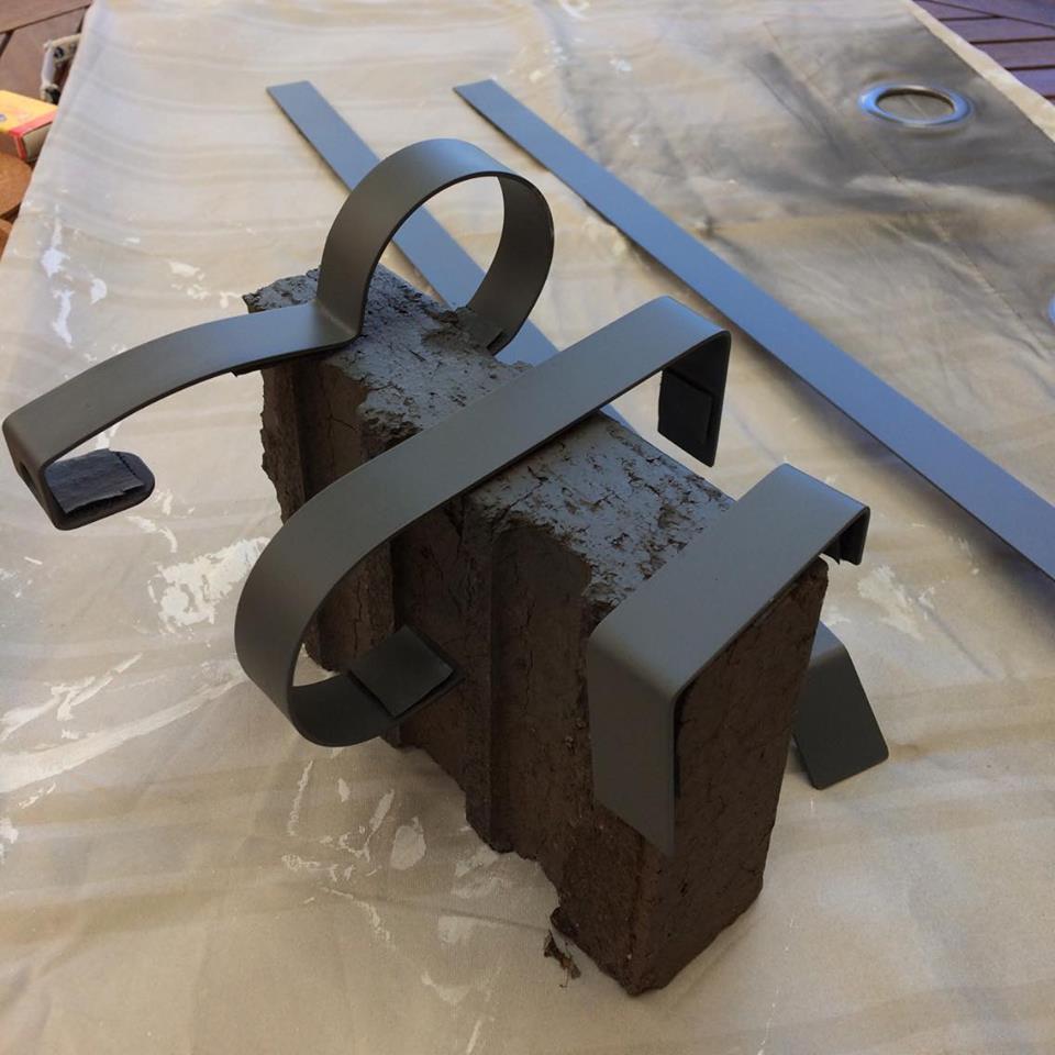

  9. Remote guard, 2 x Gen2 engine bumpers, 2 x battery guards, freshly undercoated in the spray booth*
    *spray booth = old curtain + outdoor table!
    Will do the remote guard in a stove-pot black (matches the remote), guards in a gloss black. Either way, will all be chipped & scratched shortly :) Will post a photo of them when finished. I'll put together a how-to on the remote guard as it was pretty easy to make. 17203682_10155134361634365_1484483513_n (1).jpg

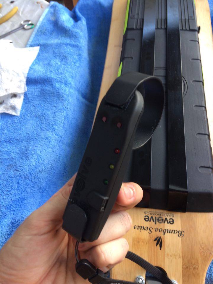

  10. Alrighty, painted :) Unfortunately it looks like the first coat of the black shrunk a bit, so made a few cracks. Isn't a biggie. These two shots show the front & back fit. It's very tight! 3 Dots of Velcro but not sure if they're required. Really locks it in. 17203910_10155135083919365_1877075185_n.jpg 17160954_10155135083879365_912234083_n.jpg

  11. wxppf
    wxppf Member
    how did you bend it?? by hands? follows the shap of the remote very well
  12. Yeh started with the 'bottom'... Use square pliers to get as square as I could and my technical super special bending jig for the 'rounded' sections.. (tube of silicone/liquid nails) to bend the aluminium around.
    Managed to make one for a friend's GT remote in about 5 minutes :)
