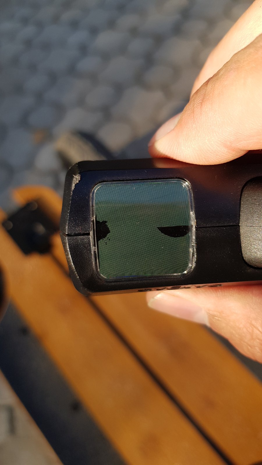

    Anyone else had this happen? First, I'm an experienced Evolve rider, 4 years with BGT/CGT and had my B GTR for about 2 months.
    Had the rear wheels lock up while riding on a smooth road, going fairly slow (about 15-20 km/hour) without any user input on the remote. Felt like full 100% brakes hitting instantly. Caused me to fall and hit hard on both hands (wearing gloves), probably re-injuring a wrist injury I got a few years ago riding my CGT.

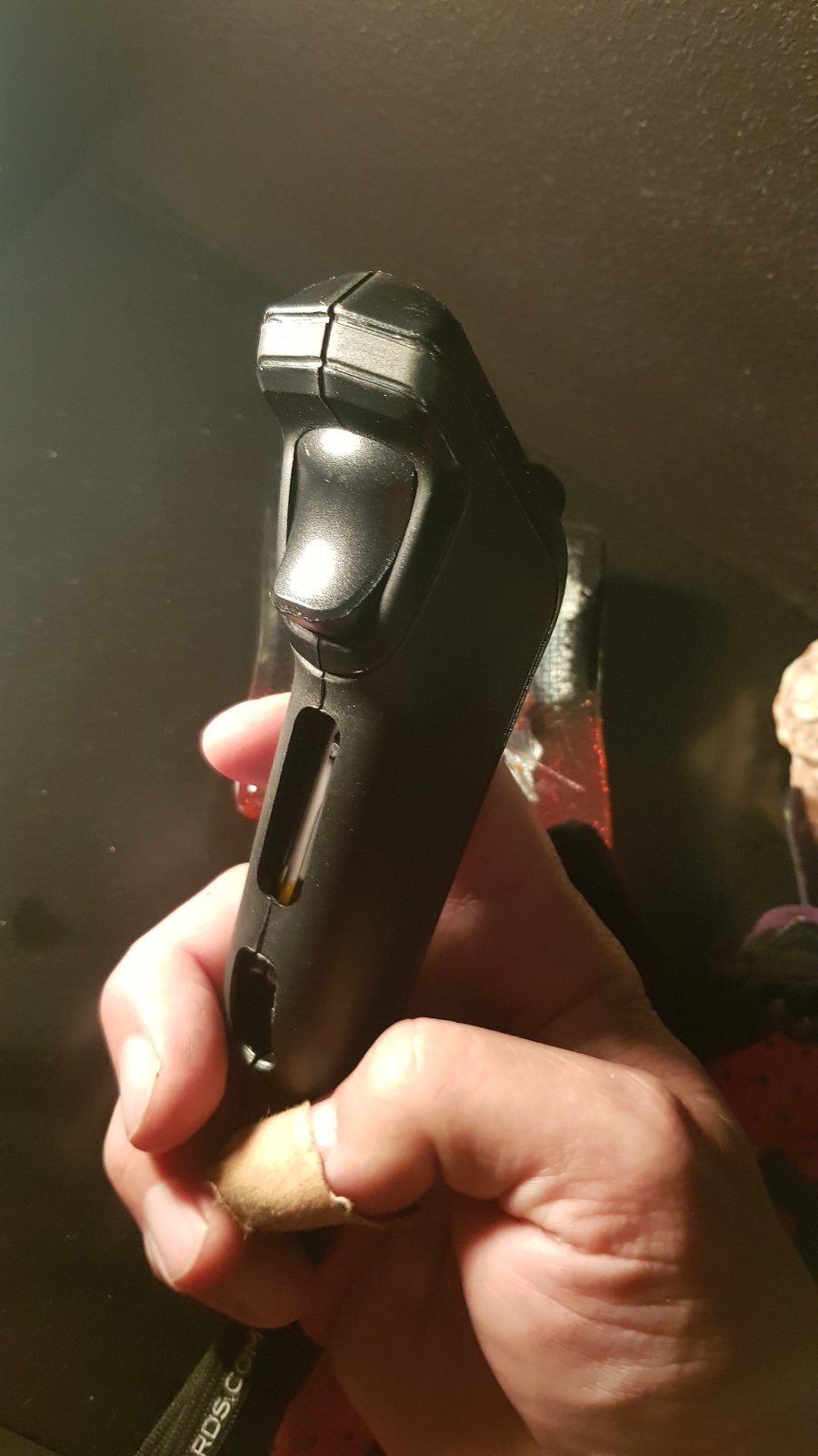

    My initial thought is this happened due to a previously damaged GTR remote control. A few days after I got the board, I (of course) dropped the new remote, only a couple feet onto outdoor cement tile. It hit just at the front edge, causing the LCD display to die. Controls still operated OK (seemingly) and I could still use the board fine, but without seeing the display. Both the throttle and brake were not hit and operated, it felt, the same as before the drop.
    Anyway, board and remote had been working fine. Tonight, was riding in a nearby park, smooth surface, after dark but with double lights on the front. Just going along, heard the wheels lock up, and it felt like I hit a huge rock that locked the wheels. Before I knew it, I was on the ground. Luckily, wearing gloves, helmet, heavy jacket - no cuts, but hit wrists pretty hard.
    Then I checked to look for the rock I must've hit, only to be dumbfounded that there was no rock there. I thought, ok, maybe a small one got caught in the gears where the cover is, nope, nothing. Wheels turning freely. Totally normal mechanical operation. Not locked up, nothing rubbing, no marks from a rock or anything hitting. The wheels just - totally - locked up while I was riding. With no outside impact, it had to be from the e-brake. And no, I did not accidentally hit the brake, I'm sure of it.
    Have there been any other cases of this? Sudden full brake application without hitting brake on the remote? I thought the disconnects of the bad old days with the GT were bad, but I have to say, instant 100% brake is worse than just a momentary disconnect.

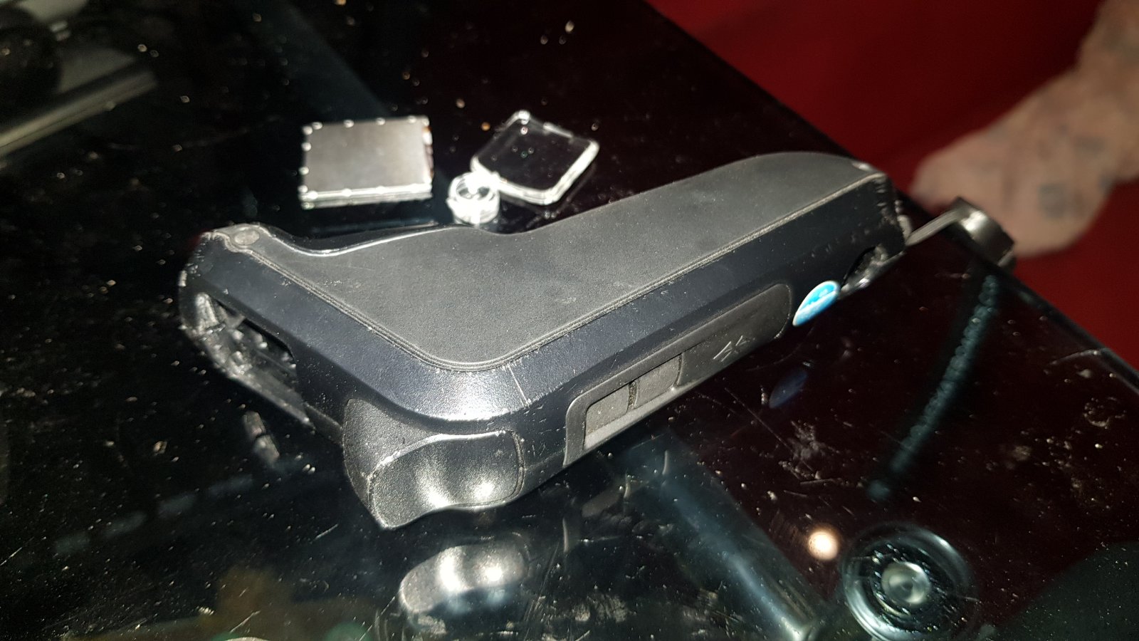

    I love the new board and the improvements the GTR has. And the new remote is much prettier and more user friendly - but - it's WAAAAY more fragile than the old GT remotes. I've dropped those dozens of times, crashed with them, they just still keep on going. My GTR remote became basically unusable after a 2-foot drop, and then possibly sent me flying to the asphalt this evening. And after today's crash, which wasn't really that hard of an impact to the ground (for the remote), the GTR remote is totally destroyed. I've had similar with the GT remotes and again, they're both fine.
    Any input, or alternative theories how this may have happened, would be appreciated!
