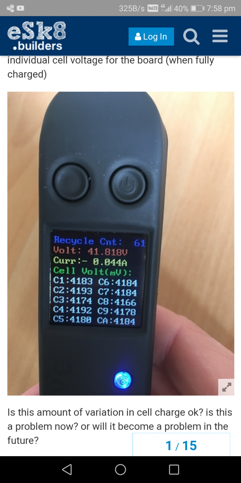

    Last week I got my first Evolve ! Stoked :)
    I found a few threads about the old remote but not a heap on the newer R2 , is there any manual so i can use the remote to its fullest ?
    Im wanting to understand my boards battery and also if I should charge it after only using half battery ? I don't really want to leave the board with only half battery as I may need a full charge next ride but concerned that constant chaging of a half flat battery may be bad for it long term .
    Is there a way to read the battery cells on the new R2 remote like was possible with the old remote like in this picture ?

    You can get to the cell voltage screen by double clicking the power button to access the preferences menu. Then use the down button to scroll to more info. Press the power button to select the battery screen. Once there, you just need to double click the power button then quickly press and hold the up button until the cell voltage screen appears.

    Thank You very much , that worked but now...how do i read it , lol is that Recycle Cnt the amount of charges ? Ive charged my board 7 times but that number is 16 on my R2 !
    Am i alright to charge the board after only 10kms and half battery ?
    Are there any tips or a manual for the R2 and board charging ?
    Sorry for noob questions but i just want to maximise my board ;)

    But what about the charging ? From what ive been able to find it inconclusive . I guess im just going to charge it as needed and hope it lasts .

    Any time you connect or disconnect the charge cable, it counts it as a charge cycle. Even if you only connect it for a minute or don't charge it to 100%. Charge your board as you need to ride it. When not using your board, lithium batteries do best stored at 50% charge.
