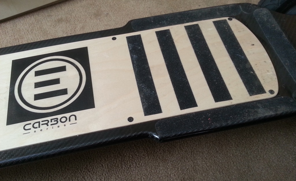

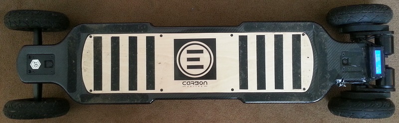

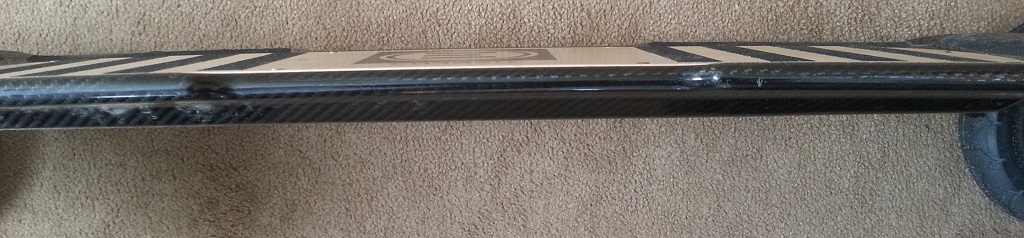

    Ok, so I was able to make them fit my BGT but I would not recommend anyone else try it. Yes you can make it work but to do so I had to grind one of the trucks make a relocation plate and drill new mounting holes in my deck. After all that you end up with a deck that handles worse and does not carve as nice, but it is a little bit smoother. I swapped mine back to stock after riding it for 15 mins.

    thx for the pics, so the Evolve GT trucks do fit aswell.
    You did the the relocation place, because otherwise your deck hit the motors? Why not use riser pads?
  9. Nickelberry
    Nickelberry Member
    Yeah that's right, the motors were hitting the deck, I did try using riser pads, I had about 10mm in there and that still wasn't enough.
