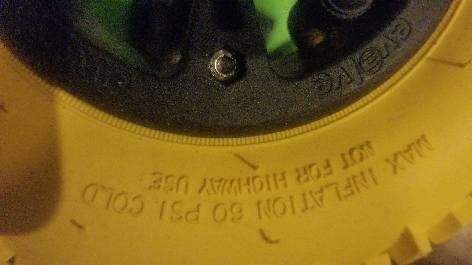

    No idea what tire pressure would do to evolve hubs.
    80 seems high only because my tires say the maximum is 60 psi, but I do tend to put in a tab bit more than that.

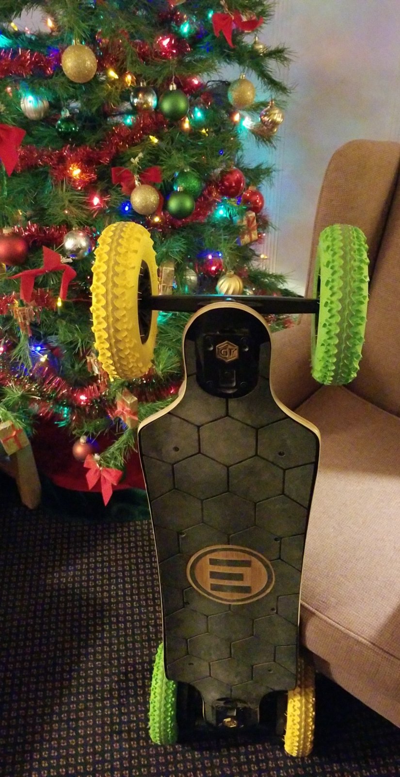

    I have 8" inch MBS on my GTX (see photo) and there is some slight rubbing on the belt covers from the tread. Not a huge issue but it's there. You can slightly feel it when turning. I think it's a none issue with bigger wheels (like the 9" inch MBS) because the tread should be higher than the hub covers.
    I just slapped these wheels on because they are knobby and better for off road/mtnboarding.

    Weird they still have vines available for purchase on their site. Wonder how many they need to sell through? And fair enough just saying my tires says (side note yes it's winter here):
