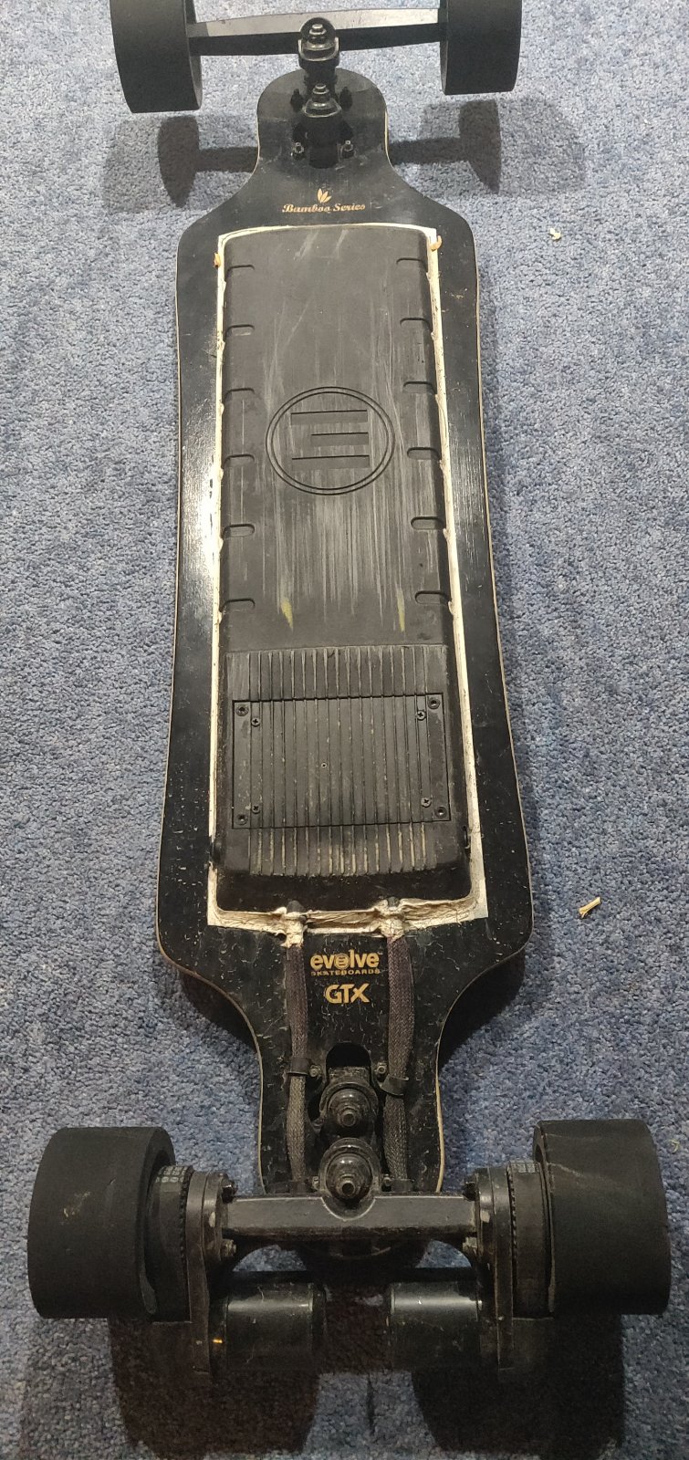

    I have water proofed my GTX. I'm getting more and more brave riding in the wet. It is after all winter and it's just impossible not to ride when there is moisture around.
    I firstly sprayed all the components inside with corrosion x hd. They go quite yellow after application.
    I then used silaflex marine sealant around the enclosure. I reccomend you also fill each screw hole with silaflex rather than o rings. The top of the deck pools water due to the concave nature and it needs to be a really good seal to keep the inside of the enclosure dry.
    To keep it tidy it's a good idea to use making tape before application.

    Great work, it does look difficult to get a good level of finish at the rear of the unit with the cabling etc. I personally think I’m going to try a gasket method.

    What are you going to do where the motor wires come out of the enclosure. It's an area which gets alot of spray.
    The mesh around the wires is porus which means I always need to stand the board up after riding to stop the water draining in.
