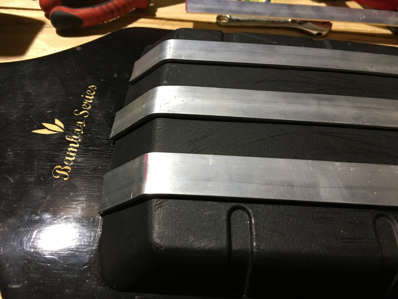

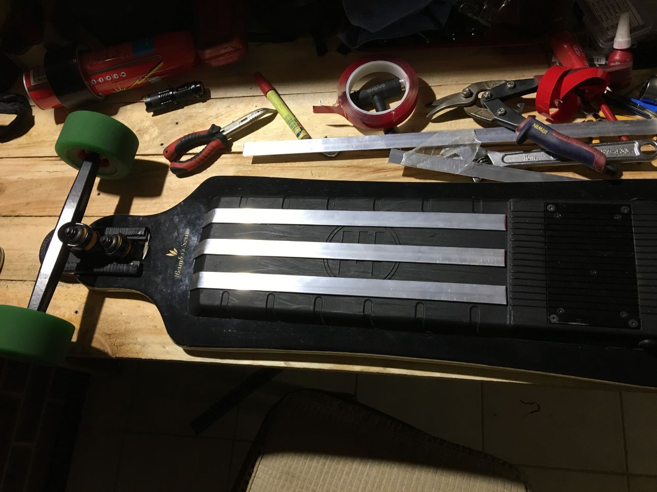

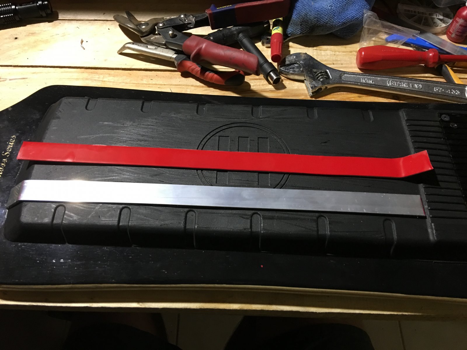

    Hey Guys and Girls,
    I was getting pretty sick of scraping my battery pack against curbs so I went down to my local hardware store and picked up some thin strips of aluminium (20mm wide) and some super strong "industrial strength" double sided tape. I then cut the aluminium and bent the front of it to match the front of the case. I ended up using three strips all up, I think that should give me heaps of protection. I went with think aluminium as it should flex with the board. Its not super pretty but I think it should work pretty well.
    Capture.JPG .

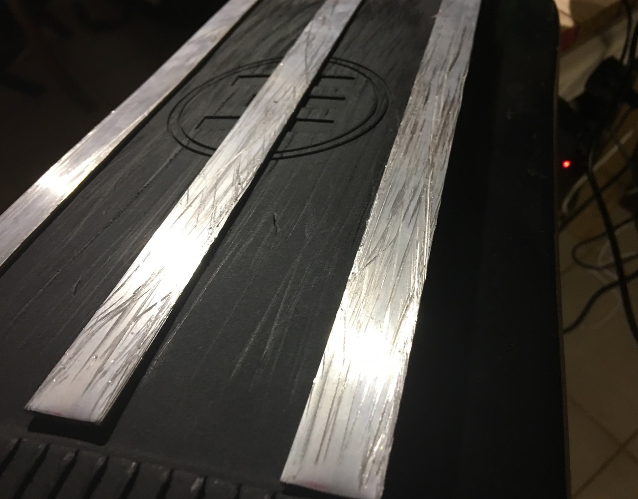

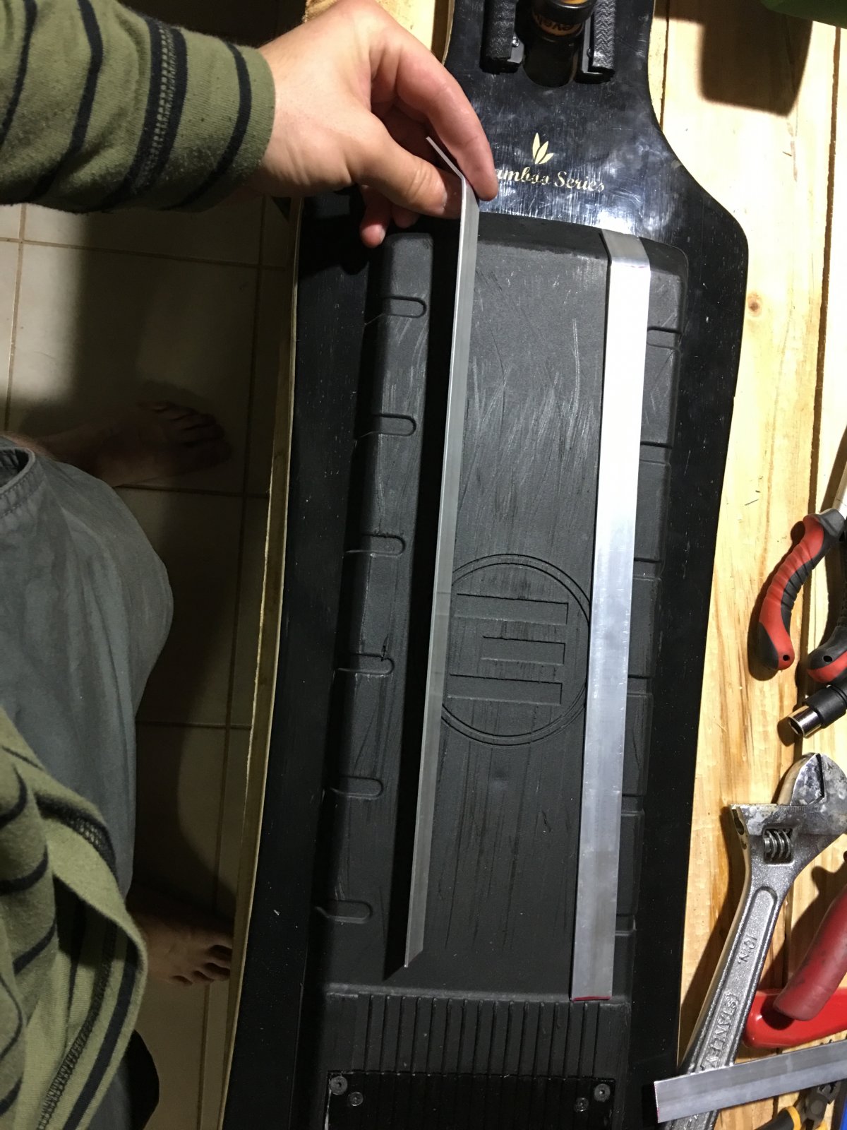

    UPDATE
    After using these for the last couple weeks I must say i really like them. Because the aluminium is pretty tough when I do hit a kerb I tend to slide over it. Before I had installed the sliders the plastic would hit the kerb which would pull me up pretty quick.
    I have made one modification which was to move the outside sliders to the edge of the battery case to protect the motor controller bulge. Screen Shot 2017-01-15 at 10.01.37 pm.JPG

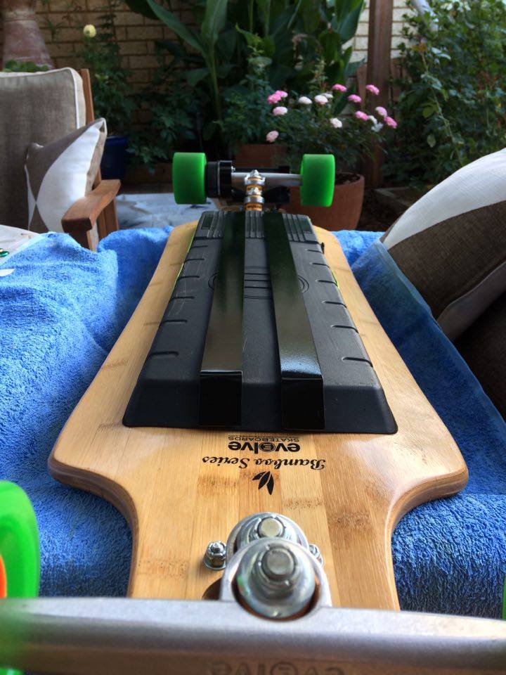

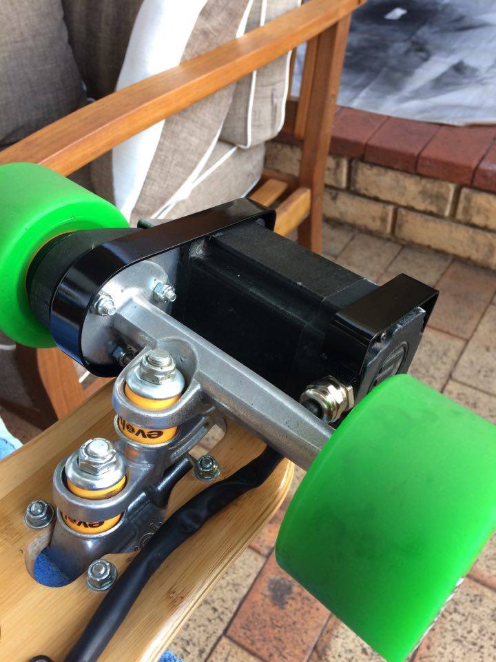

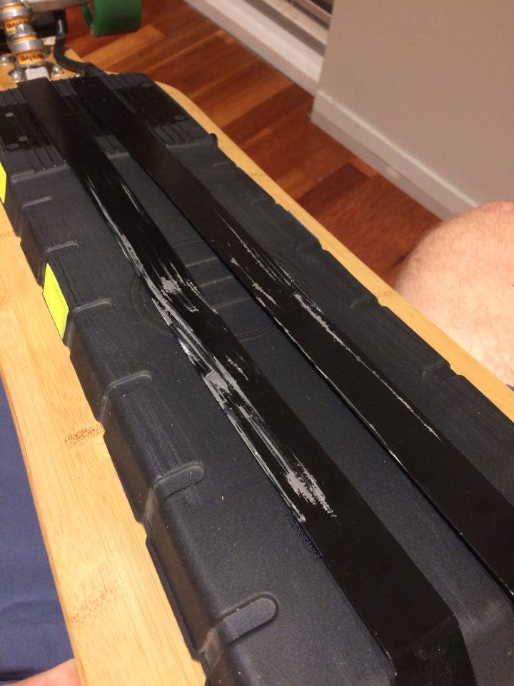

    Definitely would have been better if I'd done this 'before' the bottom got a few scratches.
    Made a couple of motor bumpers also, but will see how they go for rattle.. might not be worth the hassle. But the trucks/motor arm is quite soft metal for what it is.
    17198098_10155135083814365_2108395018_n.jpg 17198557_10155135084014365_1856616554_n.jpg

    So glad I sanded, primed and glossed these! :p
    Can confirm from Nick's initial guards:
    - 3 required, I'll move mine to the outside and put a new one down the middle,
    - Velcro doesn't cut the mustard, I'll have to double-sided tape them,
    - Painting is useless,
    But from my own take on things, I'm liking the full length.

    Map
    Cody went with full length and a bend / chamfer on the back of the battery too.. might help to keep it stuck on. Double sided tape a must, I had a few 'dragging metal' moments.
    Solution might just be to fly off kerbs at speed.. something will be getting scraped up by the road that's for sure.

    Hey Andrew,
    Do you have any issues with the tape falling off the aluminium strips? At the bottom of the battery, near the controller/ chip, it is 1-2mm raised - just wondering if this affected the grip of the tape in any way. thanks

    I ended up bending mine 'up' and then 'down' to give it a little 2mm rise over the motor controller. So it sits flush
